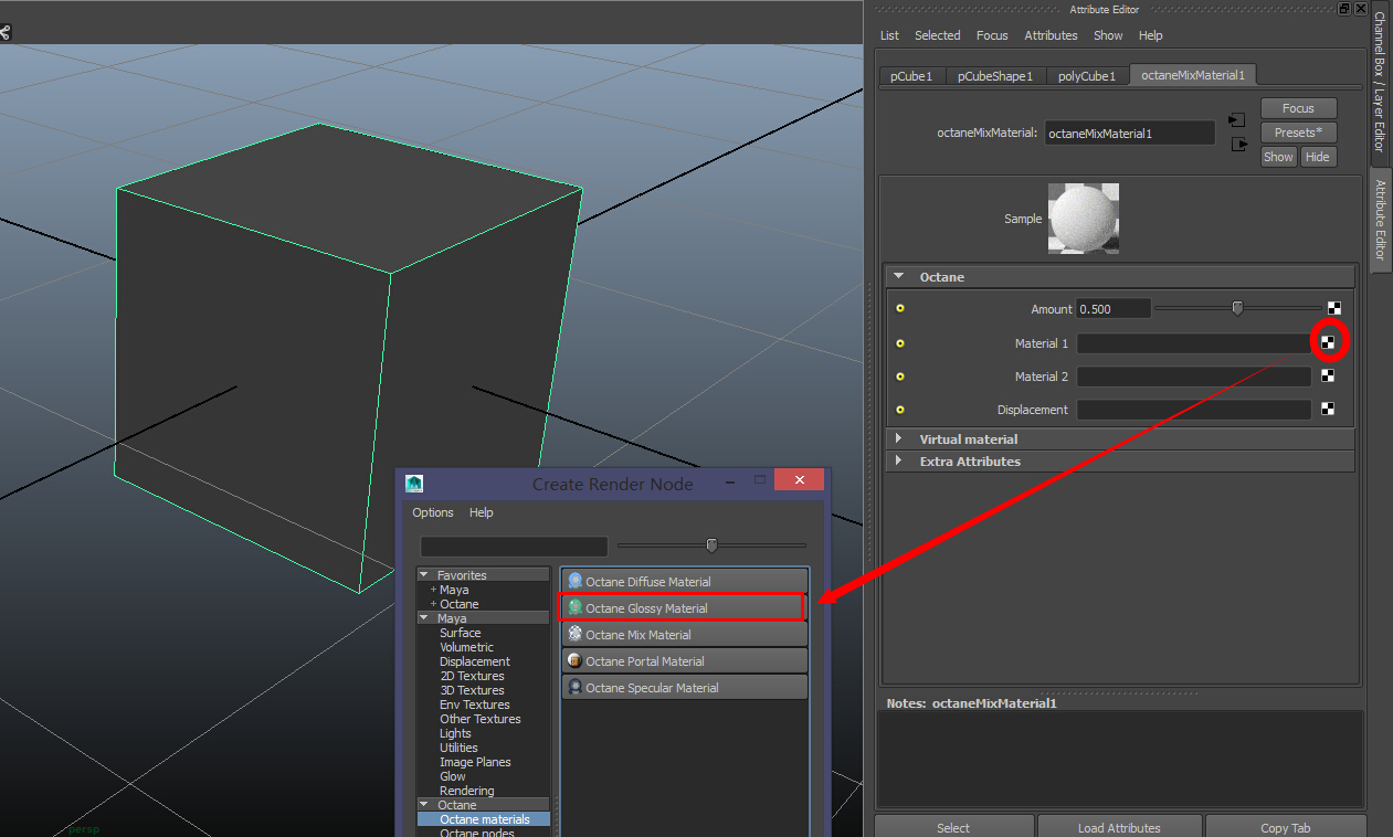

when i try to plug materials to a mix material in the attribute editor, maya will display "// Error: line 0: The attribute 'octaneGlossyMaterial3.outColor' cannot be connected to 'octaneMixMaterial1.Material1'." it works fine if i go into the hypershade and connect the materials manually. is anyone else having this issue?

alexliuzinan wrote:when i try to plug materials to a mix material in the attribute editor, maya will display "// Error: line 0: The attribute 'octaneGlossyMaterial3.outColor' cannot be connected to 'octaneMixMaterial1.Material1'." it works fine if i go into the hypershade and connect the materials manually. is anyone else having this issue?
Have you tried connecting the .outMaterial instead of the .outColor?

Thanks for the reply,i'm using Maya 2015 and everything works fine if i work in the hypershade, but i was more used to connect nodes simply by clicking on the little checker button under the attribute editor. it worked fine in the previous versions, but the new version seems to connect the mix material with the .outColor of material1 instead of the .outMaterial. its a super minor issue, i can work around it, but it would be cool if it can be fixed. could you by any chance try it on your computer and see if the same thing happens? im not sure if its a bug or just something's wrong with my system.
Thanks again :)
