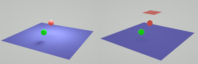

I'm having some troubles with commandline rendering. Not sure if this was in ealier versions already since my previous renders were always submitted from within maya using Render>Batch render so it might not something specific for this version/built.
Currently I'm using the commandline to start renders because that way I can build a queque and distribute them more easily over the different computers. The command i'm using to start my renders is:
"C:\Program Files\Autodesk\Maya2014\bin\Render.exe" -r octane -s 31 -e 40 -b 1 -proj "P:/client/projectName/Creation/3D/MAYA" "P://client/projectName/Creation/3D/MAYA/scenes/TEST.mb"
The first frame of a render always looks the way it should. (left image) All the other frames in the bach don't have any lights other than the environment and show the lights as geo.(right image)
This doesn't always happen but it occurs about 50% of the time.
EDIT:
Just checked my overnight render. Unfortunately it's also happening when I render from inside maya. 1st frame is fine, all the others have no lights.
I started a new thread for this with a bit more in depth explanaition.
