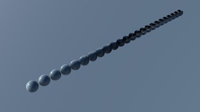

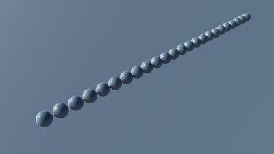

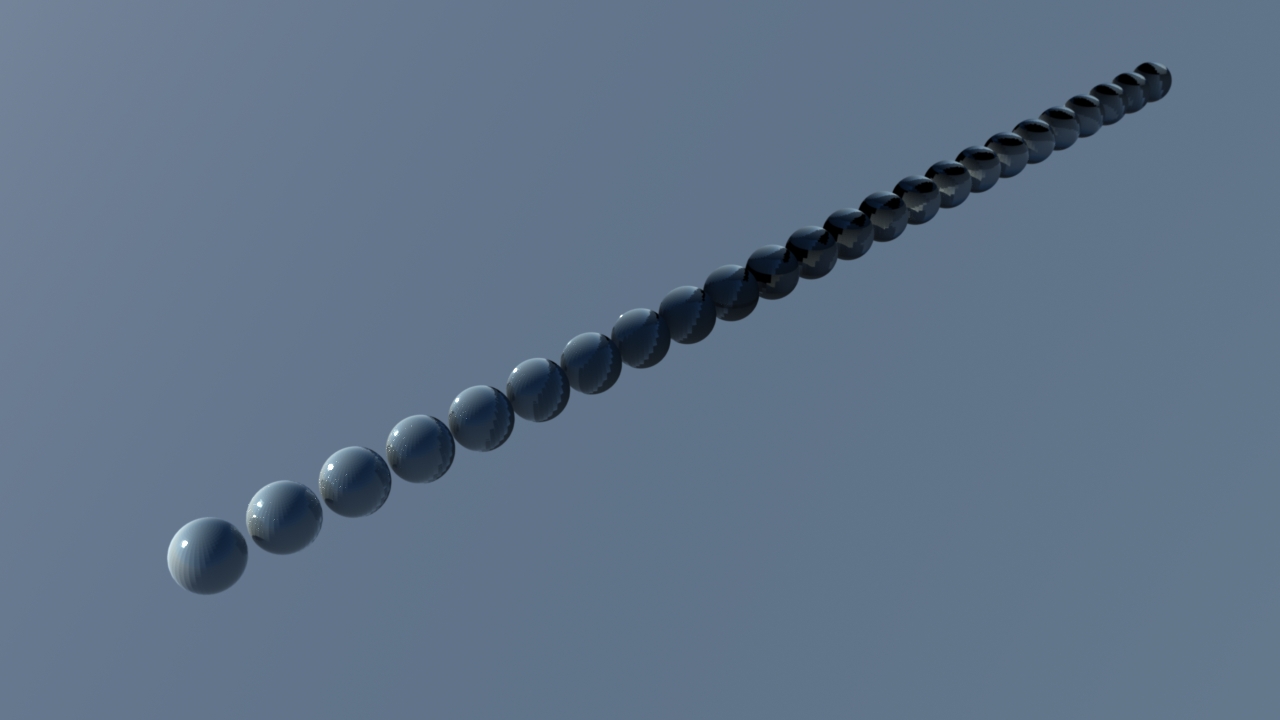

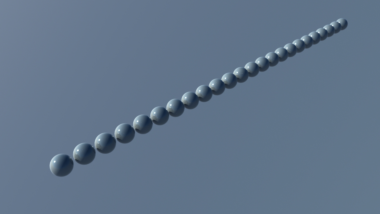

I've found one strange behaviour (it was actually there in the last version but I thought it was probably tied to the other normals bug)
If you create rotated instances their normals seem to be locked and rotate with them, however if you check the smooth option in the octane shader they come right. The strange thing is they render correctly either way in both the geo and shaded normal modes in the infoChannel kernal.
Images attached, in this example each instance was rotated 10 degrees on creation.

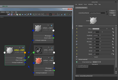

No, it took me a couple of goes too. It's a little counter intuitive, you conect an octane material to your base object and then conect the virtualMaterial out pin of this shader to the virtualMaterial input pins of all the other shaders. Only the first material assigned to the base object needs the virtual material turned on to random or round-robin. You can also select the secondary material in the node editor and click the add selected in the base materials attribute editor but this is a bit of a pain as you need to use focus in the attribute editor to get one material selected ad another showing. It did show me how to do it though.

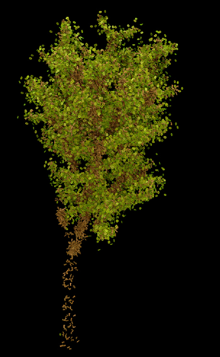

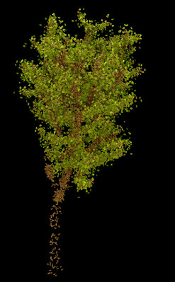

I built this binary tree using particle instances a ways back. I am guessing it is the most primitive use of instances there is but it worked at the time. I have to bone up on using particles for more creative work.
