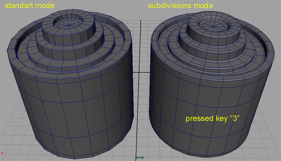

Hello, is it possible to add support subdivision mode? I mean If you want to see how the model will look smoother - you can press key "3" (subdivisions mode-viewport feature) and when i render models in Mental Ray and VRay they continue to be smoothed aftrer render in framebufer. This mode is very useful. But Octane does not support it.
Sorry for my poor English
JimStar
Posts: 3849
ZLOy wrote:Hello, is it possible to add support subdivision mode? I mean If you want to see how the model will look smoother - you can press key "3" (subdivisions mode-viewport feature) and when i render models in Mental Ray and Vray they continue to be smoothed. This mode is very useful. Butoctane does not support it.
It was already discussed in previous threads...
In short - Maya has no standard API means to get the smoothed data of object elegant way. Only by smoothing the objects right in the scene before the render and "unsmoothing" after render (otherwise the info about poligon-shader binding will be lost). It is the ugly way, I don't want to do it this way, ideally the render process must not change the scene objects.
And doing it the "right way" not only will take a lot of work (writing the redundant code that doubles Maya's "hidden" smoothing), but in addition it crashes all "plugin-engine" ideology: as smoothing the meshes must be the engine's work, not plugin's, this engine behaviour must be identically realised through API to all plugins that use it, to have the same smoothing behaviour in all Octane plugins... Instead of each plugin developer will have its own bunch of code that smoothes the meshes its own way... E.g. - Arion engine has such smoothing behaviour, so its plugins just use it giving the mesh (with bound materials) and its "smooth factor" to engine...
So, this problem is not only the coding itself, I should first to discuss it with Otoy - where must reside this smoothing code, in the engine or in plugins... If Otoy will decide that it must be the plugin's responsibility - I will add this code to plugin itself. I already wrote, that I will surely add smoothing one or the other way, just after all other, more needed things will be done... I think that you do need the instances support?..:mrgreen:

ZLOy wrote:you can press key "3" (subdivisions mode-viewport feature) and when i render models in Mental Ray and VRay they continue to be smoothed
You probably know that, but you can /Modify/Convert/Smooth Mesh Preview to Polygons
The advantage I found is that in some cases it renders faster than the subdivision mode ("3"), but you can't come back to the basic mesh, unless you have history I guess.
I know about it, but this modification increases the number of polygons and viewport are slows - its very difficult to work with the scene.
