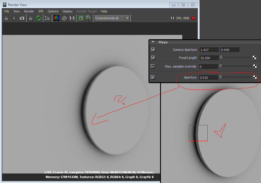

I am wondering why a minimum Apperture Setting still creates a Depth of Field effect.
Usually there shouldnt be DOF with minimum Apperture.

Refracty wrote:Great Release JimStar,
I think it is not the plugin's responsibility... only if it were some bug with loading camera parameters to engine - but I've just checked it, all is OK, the aperture is loaded to engine "as is", not changed or scaled somehow...:?
Just some thoughts:
- Have you tried to play with scene units and scale to see if it changes something?
- Have you tried to export the scene to .ocs to see how it looks in standalone?

HI JimStar,
it seems to be indeed a problem caused by my scene scale.
The plug in works fine.
