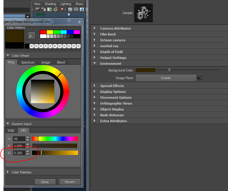

About env color: i'm not sure, maybe i don't understand something, but you can easily use "value" component from HSV triplet, especially that Maya allows to crank it up above 1.0.

Joss wrote:About env color: i'm not sure, maybe i don't understand something, but you can easily use "value" component from HSV triplet, especially that Maya allows to crank it up above 1.0.
I think it can't be used, as it has other semantics... "V" component of HSV - is the component of the color itself, but the "Power" of Octane environment texture has other semantics, it is the component, additional to color itself: it is the power of lighting of that resulting color formed before by these "H", "S" and "V". So, if we will use that "V" for setting the power of lighting of environment texture too, then we will "double-use" that same value in two distinct places:
- first we will use it to form the color itself (its shade)
- then we will use it to give the lighting power to that color
So, in this case we can't set e.g. another shade of color without reflecting the power of lighting of that color in resulting environment. But if we don't want to change the light power, but want to just change the color's shade?.. We can't do it if it is the same parameter that participates in the color building...
And vice-versa: if we don't want to change the color itself (e.g. initially it is HSV: 360,1,1, pure Red), but want to just decrease its power of lighting in Octane environment (e.g. to 0.1) - after decreasing of "V" to 0.1 we just get not only less power, but absolutely another shade of Red color too - we just get Black...:lol:

If i understand correctly, V component of HSV is just a value, color itself coded just by Hue and Saturation, so if you changing just V, you basically having the same color shade with different brightness, and that brightness can be perfectly used as a light power.
Well, maybe there's some reasoning behind of not using HSV, just thought it's gonna be very handy, just like in MR you can crank up those values for light cards.
