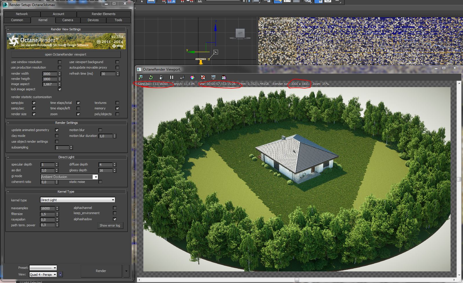

hello everyone, I need help,
problem whit render, when I have more object in the scene.
for example, with one tree (octane proxy) is OK.
but when I have more trees, scene it loads endlessly. :cry:
what I do wrong?

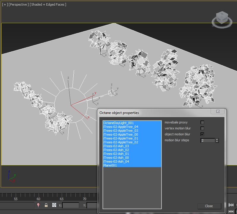

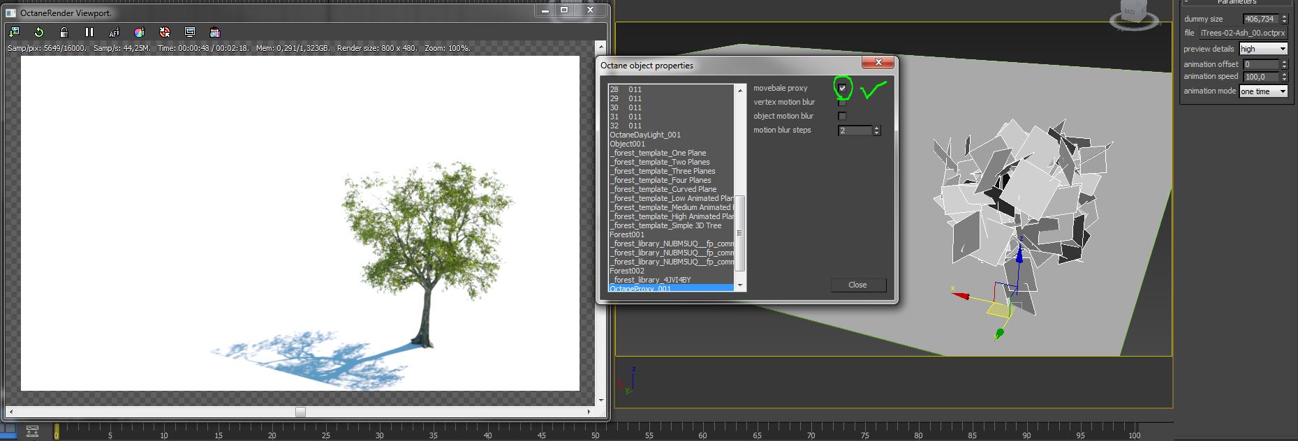

2. select all trees and right-click -> Octane properties -> Turn on "movable proxy" flag.

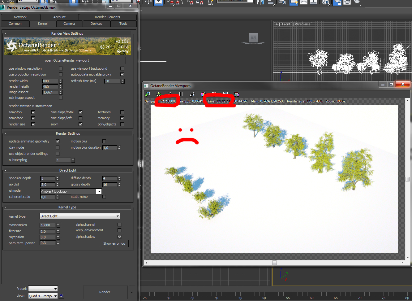

when is one type of Tree is OK
but the problem coming when is more types of trees

i have this problem if i accidentally set movable proxy to dummies or some other helpers especially linked ones. I usually uncheck movable proxy for itoo forest, if you use one.
Try to select all objects in your scene and go to their octane properties and uncheck movable proxy from all of them and see if it works like that.

Maciej wrote: but the problem coming when is more types of trees
the available memory of your GPU is too low, only 0.77GB left, are there other applications running(photoshop or ae or premiere or games)?

coilbook wrote:Try to select all objects in your scene and go to their octane properties and uncheck movable proxy from all of them and see if it works like that.
coilbook - I do as you suggest, but nothing has changed :cry:

akira wrote:the available memory of your GPU is too low, only 0.77GB left, are there other applications running(photoshop or ae or premiere or games)?
I have no other programs running, in this case ( 5 types of trees ) Octane use only 0.77 GB memory.
I have always so little memory of my GPU (max 2,0 GB). I thought it was normal

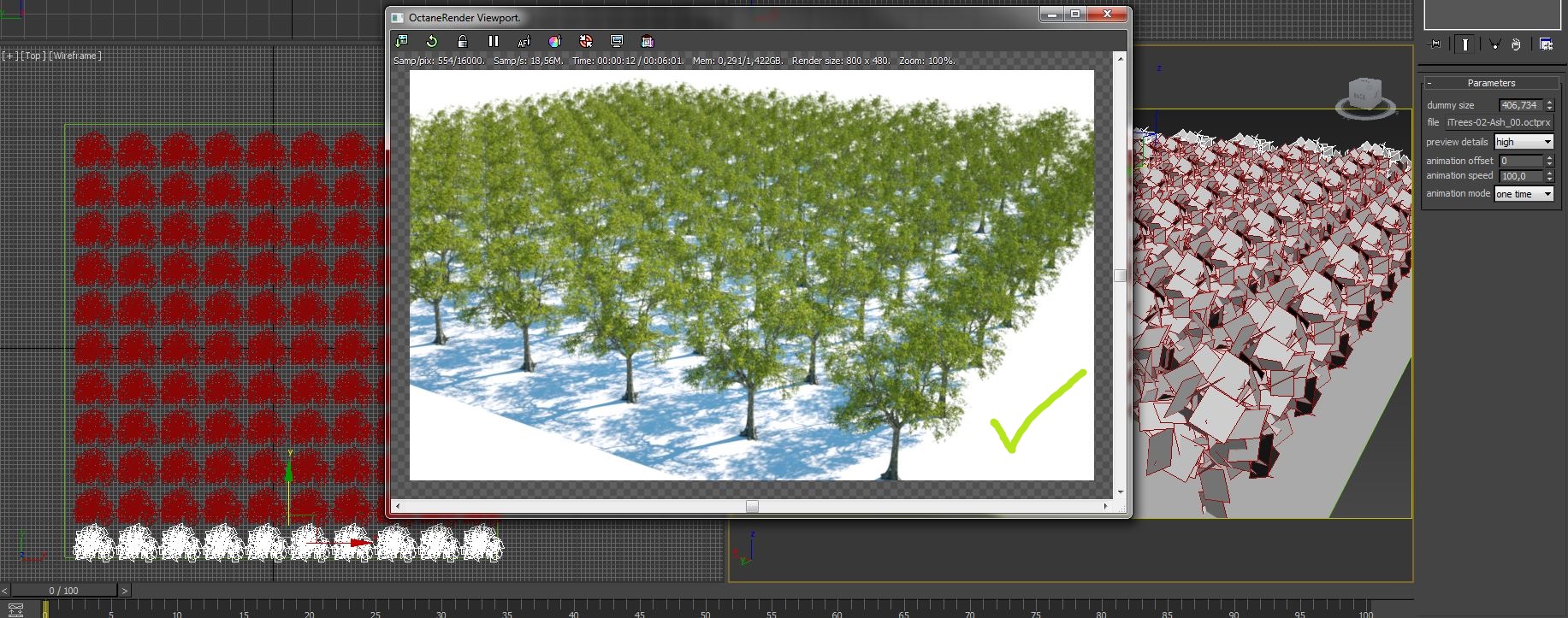

i noticed if i have like 5 trees and i instance them it will render very slow. But if I have these 5 trees and use itoo forest with 200000 instance copies of them it will render very fast. Not sure why
Same if I convert itoo forest cloud point trees to actual viewport mesh it will render like 20 times slower
