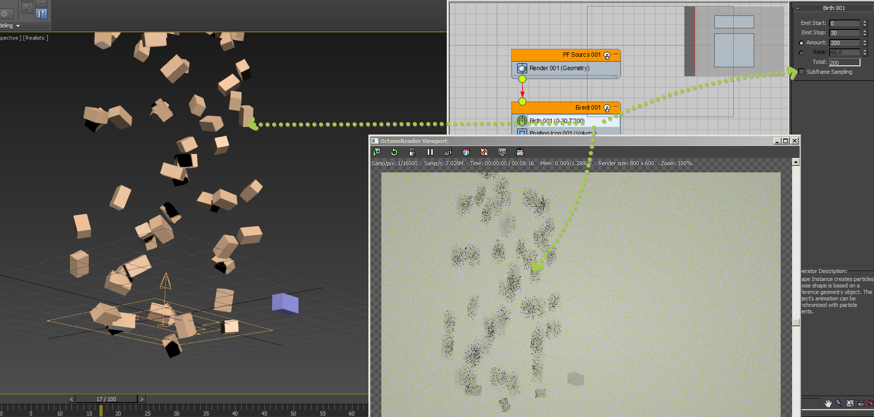

I have been trying for hours to get a motion blur effect on some simple particles using 3dsmax PFlow.
I cannot achieve the result on particles, while it works on a simple sphere that I animated by hand.
Any suggestion to do it?
Max.

Noone else is having this issue?

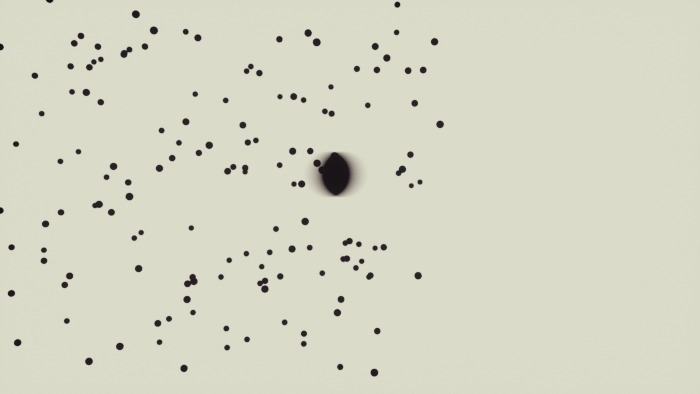

I have found that option - blur only works after the death of particles
.....through instance shape blur works
