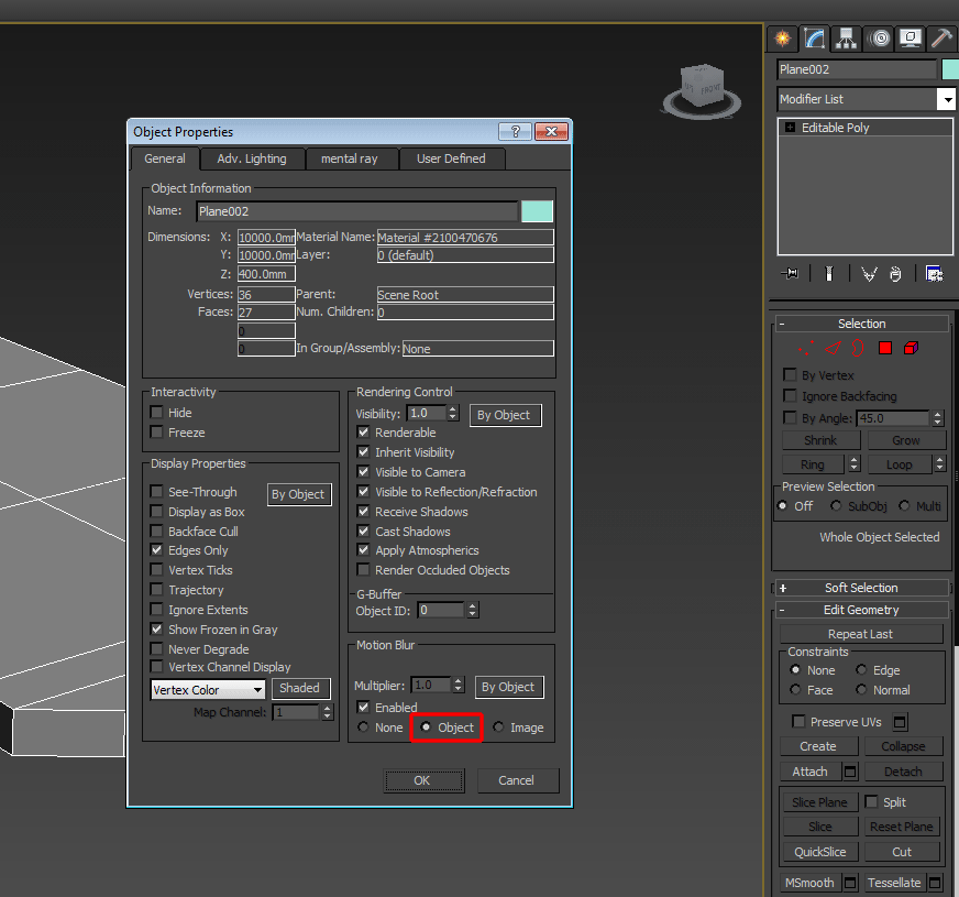

I have found the reason of the crash
The reason is hair&fur exporter which Autodesk have provided me with doesn't like object motion blur properties even if you don't use hair and fur, see attachment.
I have contacted them about the issue, but unfortunately it takes ages to get any response from them.
What I can do at the moment:
make hair&fur support as a render option.
so by default it is switched off.
if you need hair&fur you need to switch it on and make sure you don't have any motion blur option in standard object/layer properties (not octane one), see attachment
I hope it is ok for most of you
