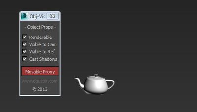

Guys,
I wrote a new script to help play with the per object visibility properties.
Script updates when you select new object.
And you can see if the selected object is renderable, visible to camera, cast shadows.
It also checks it object is visible to reflection. Mind you! it's not currently supported in Octane. I added this just to use it with other renderers as well.
You can also quickly enable or disable moveable proxy setting of the object.
I have to thank Suvakas letting me know more about that.
Thank you Otoy for the latest update.
It also works with Octane lights as well so you can tell it not to cast shadows or visible to camera.
Tell me if it works allright and I'll try to solve if you come up with any problems.
To install drag'n drop the script to the viewport.
You can find the script located under the category named "Oguz"
Cheers,
ObjVisibility_1.1.zip
(1.16 KiB) Downloaded 379 times

With Octane 1.25, visibility to ref and shadow casting properties don't seem to work.
Visibility to ref desn't even refresh the Octane's viewport.
Or maybe I missed something ?
By the way, I didn't find these properties whithout the script, if someone could enlighten me.
Thanks.
