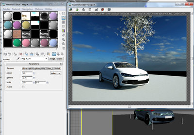

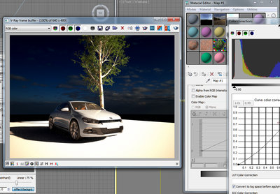

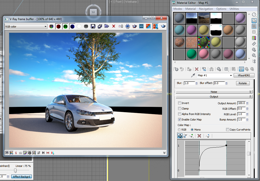

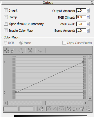

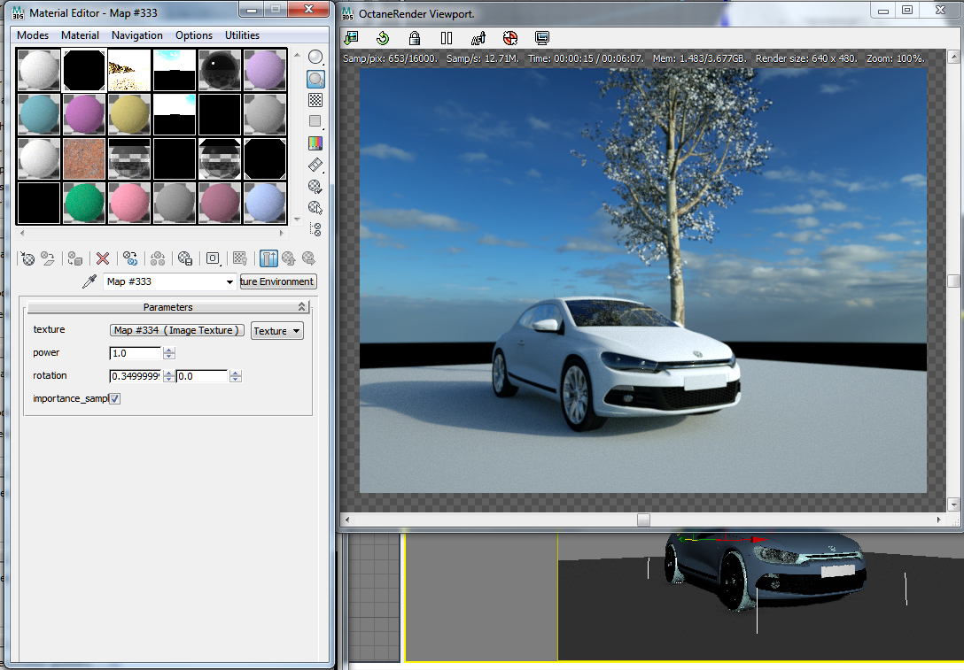

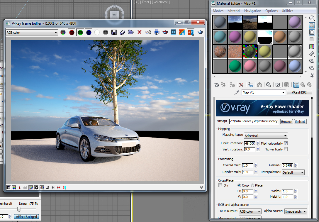

Is there any chance to adapt max's output map for texture maps. Because I always use output map for HDRI files in vray if I want to illuminate with only HDR without sun.
Infact octane render hdr support is really good as vray. But if I have an output map option I'll be happier.
I used cgskies.com 339 in this scene
Here is some sample images with vray and octane render about what I want to say ;

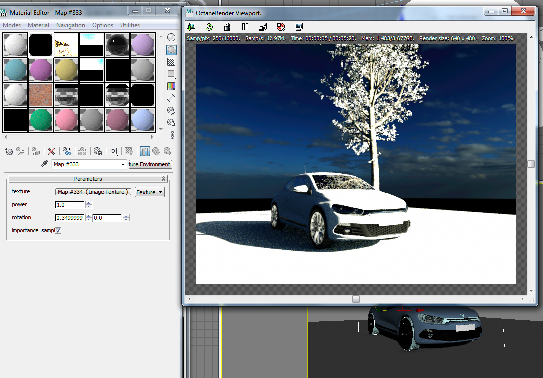

nothing to useful.only shadows are dark and crisp
not bad. but shadows must be more crisp and dark. HDR's gamma is 1.5

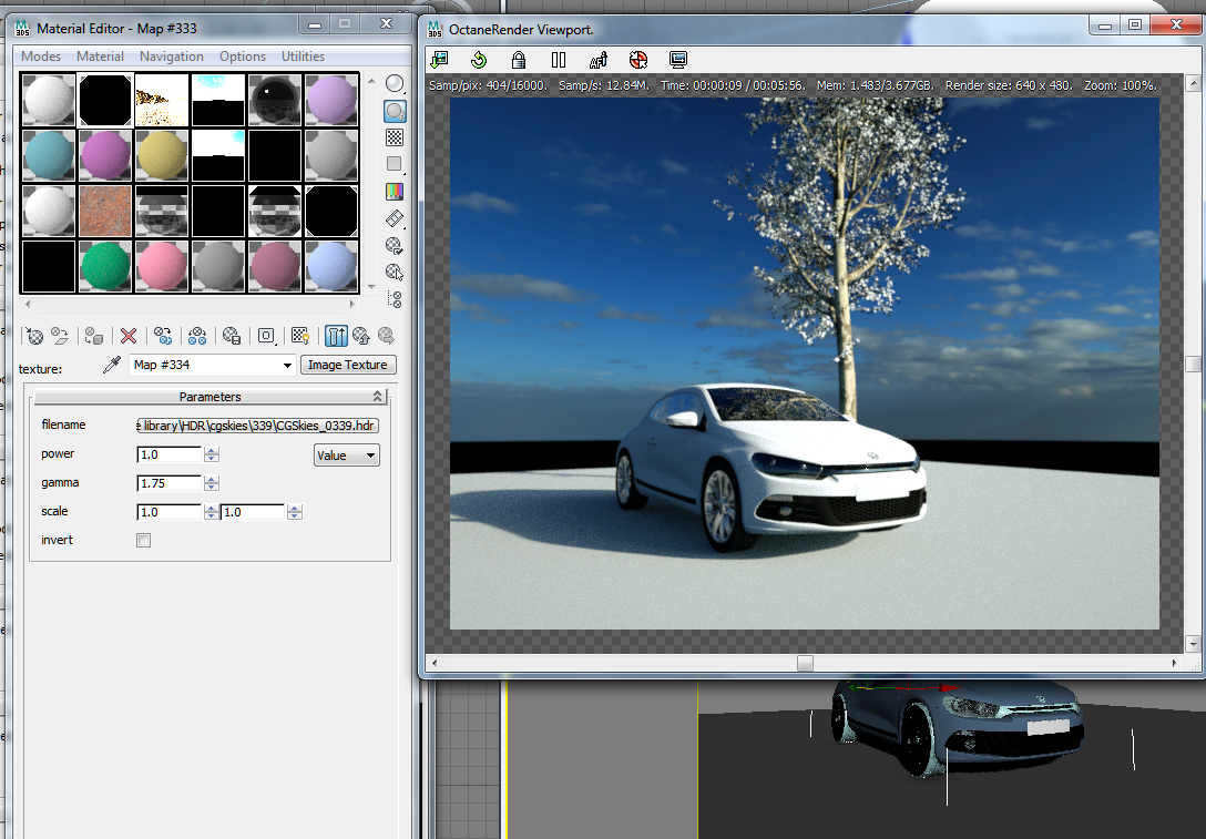

HDR gamma is 1.75. shadows are dark but background is weird.
background is not bad but shadows are washed. hdr gamma 1.45
Shadows are OK.But background is really weird. hdr gamma is 2.2

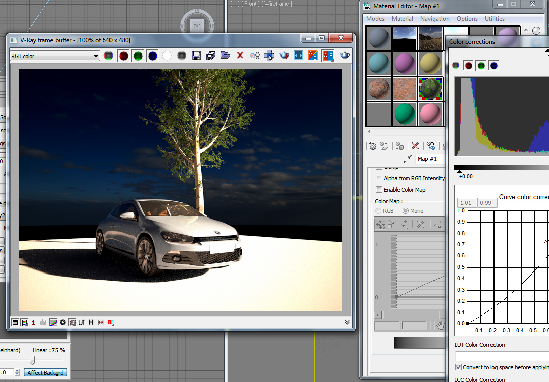

This image is what I want to get crisp dark shadows and good background.HDR gamma is 2.2 but output map tweaked for increasing mid areas.
