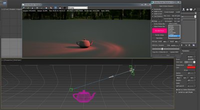

I have updated My Shortcuts Script with cool features.
I use this everyday and keep the script open at all times.
Most of the features changes and runs on the fly regarding the current object selection.
Features:
Update: 3.2
Make sure you copy the 08 ies file to your root folder of C drive.
Also Drag and drop the new MCR file again. And reopen max

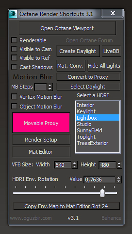

- Create Octane Camera from currrent Perspective view.
- Create IES Light with target
- Update HDRI rotation sliders in case user manually overrides HDRi's translation.
- Open Octane Viewport
- Create Daylight instantly
- Select Daylight
- Open LiveDB
- Convert all scene Materials
- Hide all Lights
- Convert Selection to Proxy
- Open Octane Forum, Active Topics
- Alter Selected Object's Visibility options
Renderable, Visible to Camera, Visible to Reflection(work only with Vray) Cast Shadows
You can also make a selected light invisible to camera. But still can be reflected in the scene.
Which there is NO way to do manually.
- Set Motion Blur Steps
- Set Vertex and Object Motion Blur
- Moveable Proxy Toggle
- Open Render Setup Window
- Toggle Material Editor on/off
- Set Render Frame Buffer size
- Select and set preset HDRI's to scene
- Rotate HDRI Environment via Slider and a spinner or reset hdri rotation
- Copy Environment Map slot to Material Editor.
