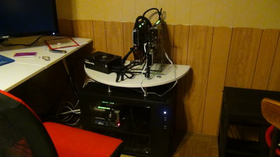

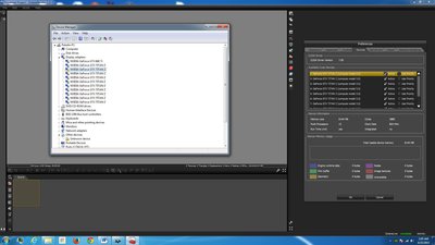

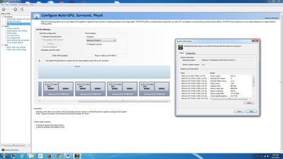

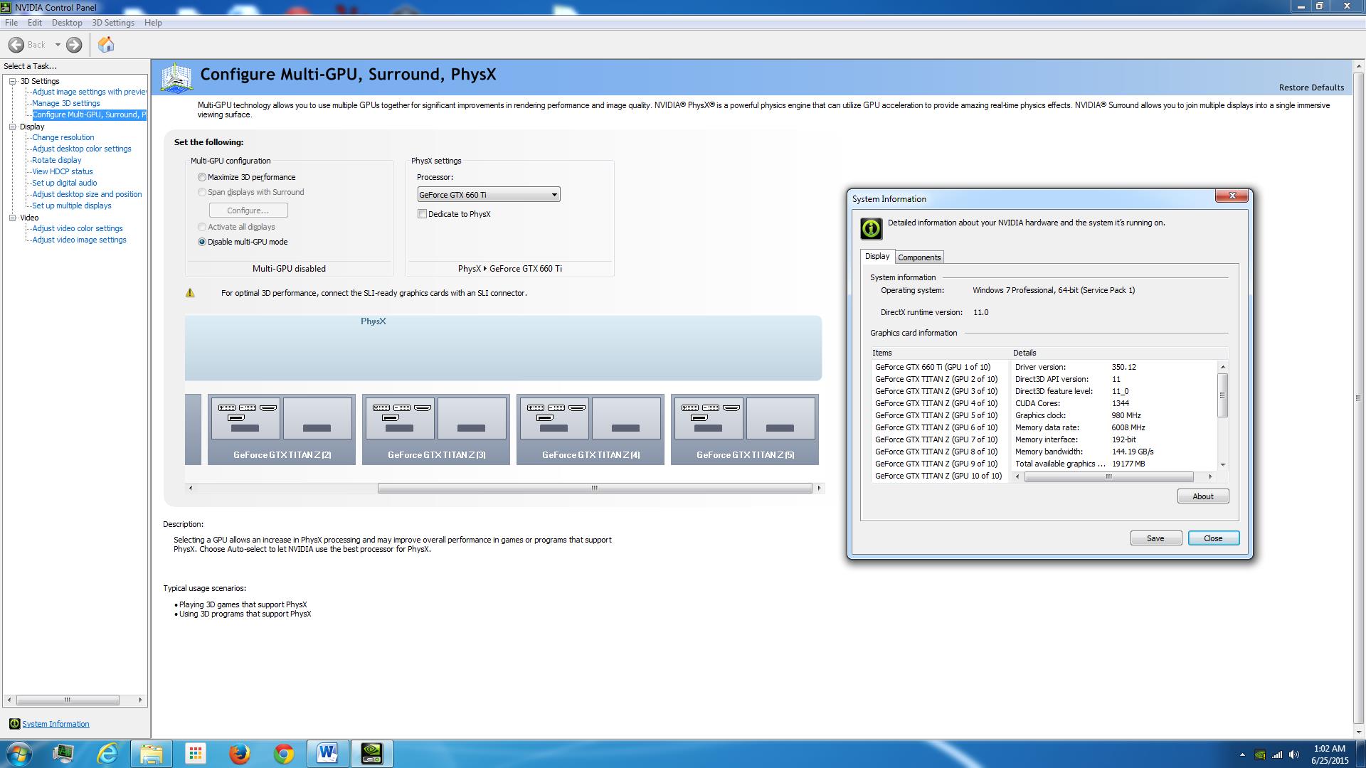

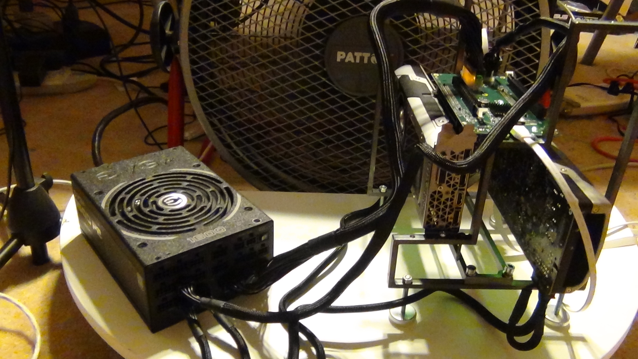

Thanks and I was originally planning on using the 1st PCIE lane for the display card. Because I have 6 PCIE lanes and the separation between lanes 1 and 2 are big enough to fit a dual slot card, though that won't be the case with the new board. I currently have the P9 X79 WS so I'm getting the step up from that and new so hopefully I can at least get all 6 GPUs up and running with little trouble. The new board should come this weekend so I'll update once I'm able.

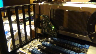

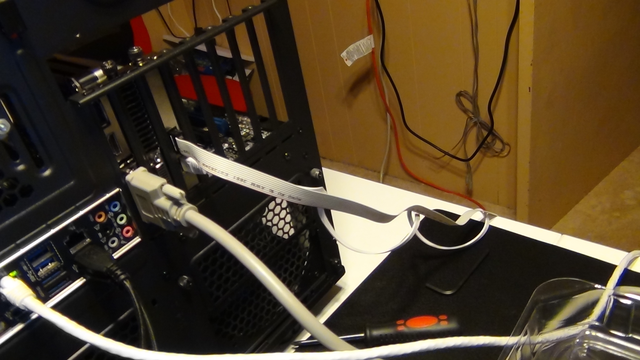

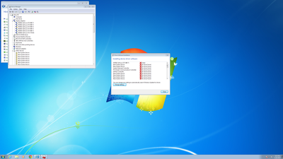

I will attempt your suggestion, but on the current board I was only able to get those 5 GPUs to work once. I tried it again this last weekend and it didn't decide to want to work with me. So that is what lead me to do that single riser test. My thinking is since each lane is not working with a single riser/ single GPU connected to it (except lane 1) Then I can think of 2 problems.
1. Since the riser works with lane 1, but can't with the others. The amount of bandwidth is to low to lanes 2-6 and can not function properly with the 1x USB 3.0 riser.
2. the amount of bandwidth in the riser needs to be bigger 4x, 8x, 16x in order for the lanes to accept it.
These are complete guesses, so I could be completely wrong. Is there a way to manually set bandwidth on the PCIE lanes? I know that the CPU decides bandwidth automatically, but I was thinking if you set it to x1,x4,x8,x16 manually it would take out the guess work for the CPU and make things more fluid. Though I'm just making guesses here. What really bothers me is that 4 GPUs directly connected doesn't working anymore, because last time I got 4 980 ti's to work no problem. I just plugged them in and that was it. Which also leads me to believe the bandwidth priority of this Motherboard is screwed up.
