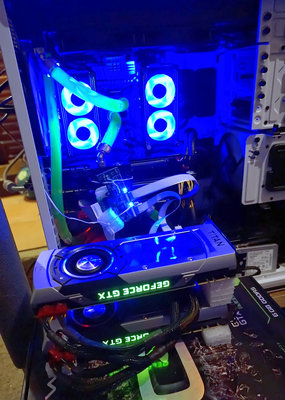

Just received the 4x splitter Amfeltec.
And still waiting for a 4x PCI-E riser (ribbon) to get access to the 3 PCI-E slot between my titans watercooled.

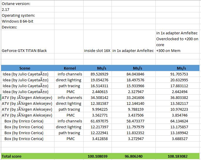

As I have a spare PC to test, here are some benchmark (base on OctaneBench) :
bench
bench
Test on a titan black

Nice! =) Thanks for sharing!
a bit curious though - rendering speed should not be influenced by running on slower interface =)

And for performance, i think that the 1x spec 1.1 is not enough (I see here a drop of 3 to 4 %).
Otoy specify at leat 4x to see no performance degradation.

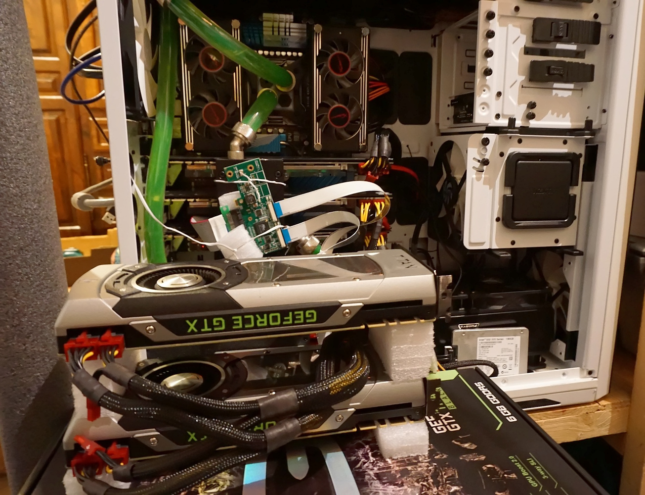

Just received the riser... chinese one but works.
add quickly the two titan black to the PC to test ... (need to make an external box to protect these GPU)
Set overclock these black a bit and result a 109 score each one on OctaneBench.
And score a 517 with all 5 titans (3 normal + 2 black).
As expected, the air cooler one get hot up to 75°C.
For the system i7 [email protected], at boot, power consumption at primary power cord is about 400W.
In windows standby : 220W (if I disable in device manager the 2 titan black, it goes up to 260W ! I though that if I disable GPU, the power should go down, but not)
When start a render, power goes up to 1460W (CPU + 5GPU) and then stablilize at about 1250W (at primary power).

Just received another riser 4x. I test to extend the previous one : 35cm length in total and its works.
