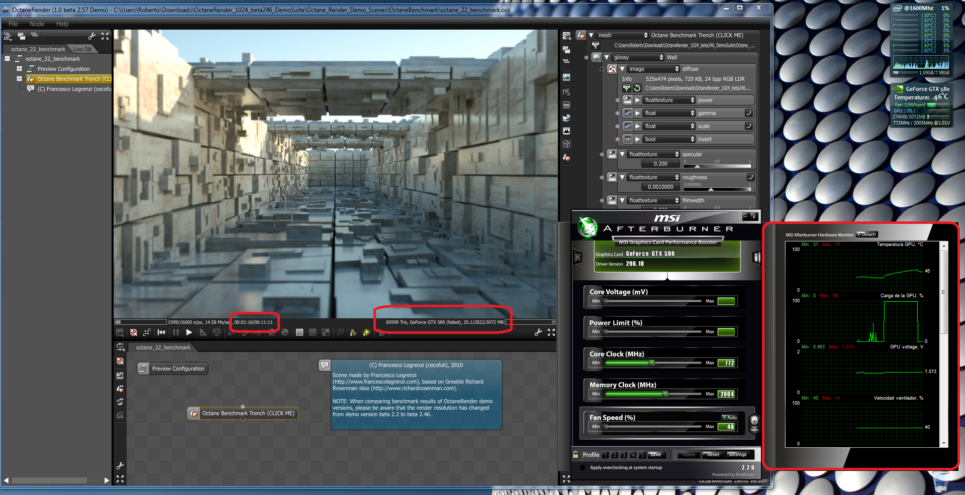

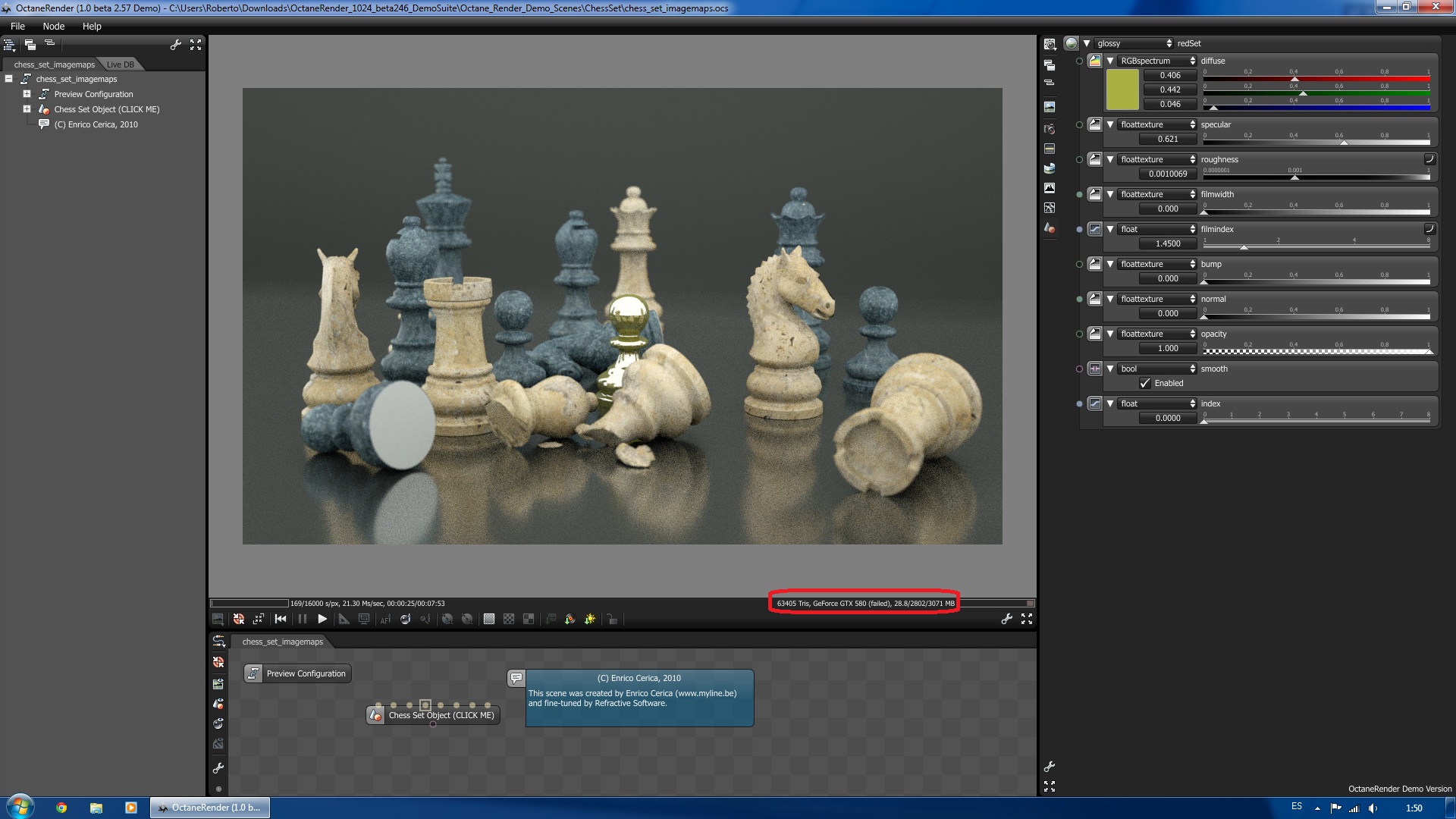

I want to buy Octane Render but I have a problem with the Demo. While I'm rendering a demo scene, my graphic card GTX580 crash after 2-5 minutes.
I attach a image with the error.
Sorry for my English :oops: and thanks!!

Postby Ansem » Thu Apr 19, 2012 1:42 pm
The PSU minimum is 600W and I have 750W and a single GTX580. The card simply stops, just like that.
I attach an image with MSI Afterburner values: GPU clock, GPU voltaje...
I tried arion render's demo and it works just fine :(
Thanks for your help folks!
