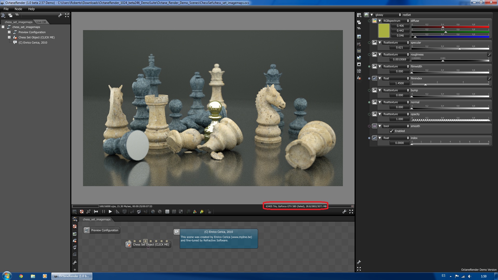

I want to buy Octane Render but I have a problem with the Demo. While I'm rendering a demo scene, my graphic card GTX580 crash after 2-5 minutes.
I attach a image with the error.
Sorry for my English :oops: and thanks!!

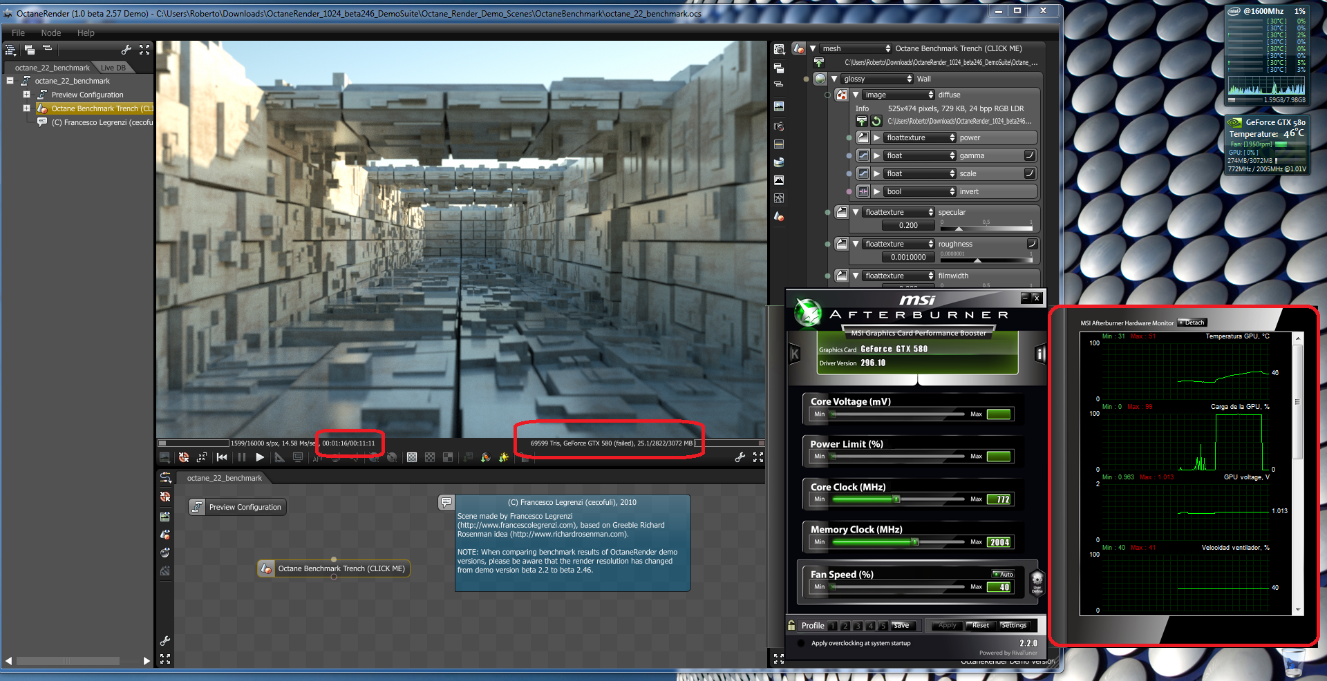

The PSU minimum is 600W and I have 750W and a single GTX580. The card simply stops, just like that.
I attach an image with MSI Afterburner values: GPU clock, GPU voltaje...
I tried arion render's demo and it works just fine :(
Thanks for your help folks!

Ok that seems to be standard clocking for a GTX580 and the power supply is adequate so we look elsewhere...
I see the driver you have is 296.10 and thats cuda 4.2
Try instead a late cuda 4.0 one 285.62 http://www.nvidia.com/object/win7-winvi ... river.html and see if that fixes it.
Remember for windows you only need the nvidia driver, NOT the toolkit as well.
