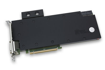

now just consider EK water block for TitanZ - & You get, dual slot card with 2x GPUs..
..that means, in regular ATX box, with capable 4way mobo You can house four of them now!!!
That's 8GPUs!!! With few rads, You can get back the performance & that's simply a MONSTER!

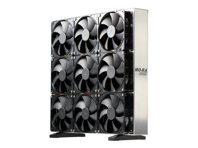

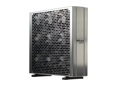

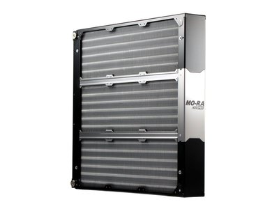

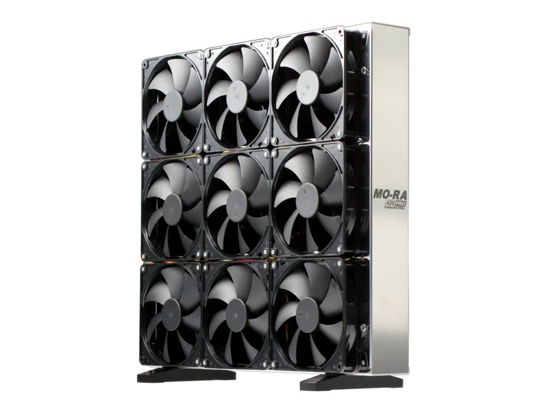

& You still wonder how to get rid of heat? here's a solution:
9x 140mm freestanding rad called MO-RA3, here are some photos:
just some info, for those who are looking for a serious upgrade!

it's a first time this card start making a sense with it's price - it should have been this way from beginning =) now I'd consider it somewhat attractive, three slots for Dual GPU - the performance is somewhat less than 2x Titans (& I don't talk about Blacks), but again.. - slap water block & You get dual slot card..- that's not even thiner, but also faster =) - so it should bring performance close to dual TitanBlacks out of the box! For dense systems that's a decent workhorse!
I am curious how well they overclock on water. If I remember well dual gpu cards were not as good as single gpu cards for overclocking (GTX 590 as an example). BTW my 780 6gb strix reaches 1300 mhz on core on stock volts. It failed just at 1320 mhz
