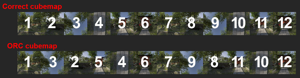

Since the stitching has not been fixed yet, I made a template to help anyone that has to re-order the images manually.
As you can see from the image below, you need to swap 2 with 3, 4 with 5, 8 with 9, and 10 with 11.
1,6,7,12 are correct. Hope this helps get it fixed sooner.

Also, remember to place the photoshop guides on pixel level, check them carefully.
Thanks guys for posting this. I'm just now realizing i'll need to do this since I need post effects, and Octane is screwing them up majorly with the linear cubemap layout.

Yeah, the post effects needs to be applied in Photoshop or in a different software.dotcommer wrote:Thanks guys for posting this. I'm just now realizing i'll need to do this since I need post effects, and Octane is screwing them up majorly with the linear cubemap layout.
